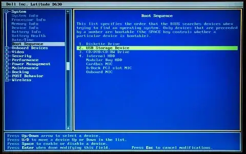

As the D630 is an older model I don't believe UEFI has anything to do with it. Double check system requirements here I would avoid unetbootin as in my experience success is rare. I've had excellent results using dd to duplicate the iso to a USB flash drive. The process to do so can be found in here. Basically you just connect the flash drive you wish to install the image to and insure it's not mounted then issue the commands which you will need to edit as explained below. DO NOT copy and paste. Read the entirety of the answer and insure you have the device name correct before proceeding.
sudo dd if=YourUbuntuImageName.iso of=/dev/XdY
sync
Where YourUbuntuImageName.iso is changed to the name of your Ubuntu iso image and /dev/XdY is changed to the device name of the flash drive you want the image duplicated onto. dd uses a default block size of 512 bytes which you don't have to change. If you want a progress report during the "burn" you can install dc3dd with sudo apt-get install dc3dd and substitute dc3dd for dd in the command. The output of mount and sudo fdisk -l can be useful in determining the device name.
This will result in a USB bootable installer for Ubuntu. Boot from it using BIOS (I believe the D630 will let you choose the device to boot from if You repeatedly tap F12, to get the boot options menu) having booted from the installer, install Ubuntu normally choosing as the target the flash drive you wish to install to.
Installing Ubuntu to a flash drive is no different from installing it to any other drive. Your BIOS determines which device is booted from. You can create your own "persistence" with normal partitioning methods if you want home on a separate partition but installing Ubuntu normally to a flash drive will result in persistence of settings and installed apps (just as installing to a hard drive would) anyway so it's not truly necessary. Here's where you make the changes on a Dell D630 to allow USB Boot. F2 at Dell Logo should get you to the BIOS.
DellD630Boot
