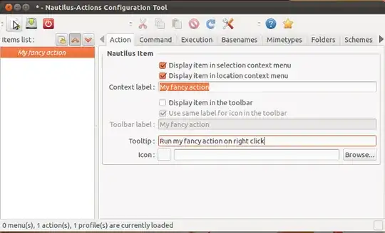

  • In the Action tab give your action a sensible label, e.g. "Open in Terminator" and choose to display this in the selection or the context menu.

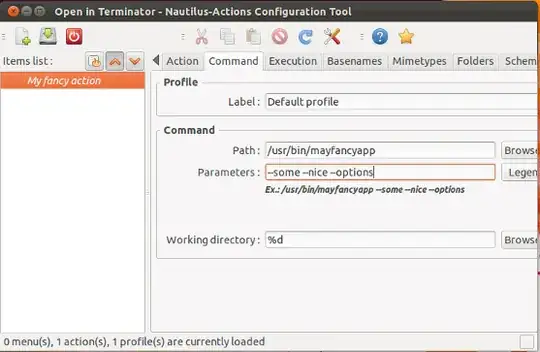

  • Next open the Command tab to enter the commands to run
  • Give in the full path to your command (/usr/bin/command_to_run) and program options.

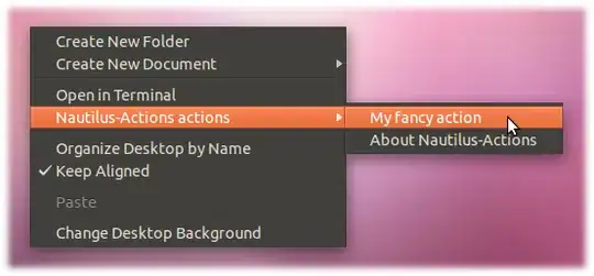

  • After logging out and in again the right click context menu below will be displayed:
