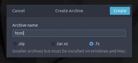

In Ubuntu 16.04 i right click folder and select compress type and split size
but in 18.04 compress menu not like before and choose type menu in gone
i install unrar zip unzip p7zip-full p7zip-rar rar file-roller

Unfortunately, the nautilus extension for fileroller, which now provides the right-click option and the dialog, indeed does not anymore support the creation of alternative archive formats, even if the supporting application is installed. You will need to resort to an alternative approach.
1. Use fileroller directly
Fileroller itself still maintains the rar support. Thus, you can open fileroller (search for "Archive Manager" or "fileroller") and create the rar archive from there.
