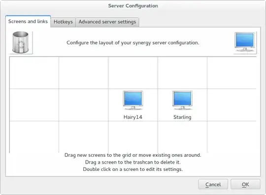

What did I use this for? I have a program called synergy which is for using 1 mouse and 1 keyboard across many computers, using a local network.
You can set it up to have your screens next to each other like so:
However, (because this is the free version), I can't drag and drop files between them. So this dock is set up between the two screens, and when I drag a file I can drop it there - and it copies it to the same path on the second computer (if it exists) or to the misc folder.
