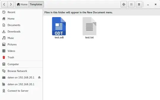

Create a new (empty) file with the file type of your choice in ~/Templates, eg a simple (txt) file:
touch ~/Templates/empty.txt
After that you can create a new file with a right click in Nautilus.
Example screenshot
