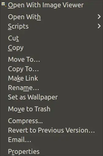

Open Nautilus and navigate to your directory with wallpaper images. Find an appropriate image and right-click on it. This drop-down menu appears:
Nautilus Right Click Drop Down
Click on the third option Scripts. Another drop down menu appears with all your scripts:
