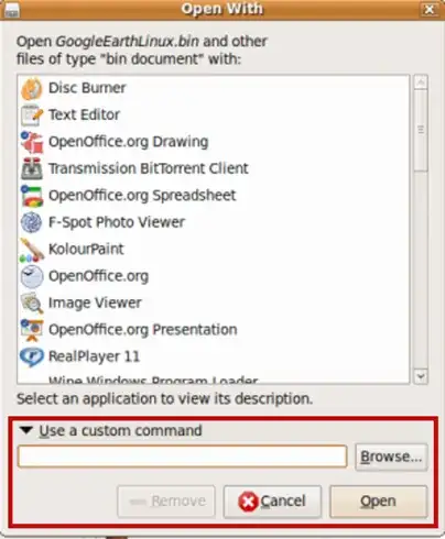

Prior to Ubuntu 11.04 there was a nice feature "Use a custom command" under "open with" menu on right click on a file. One could able write a command in the box to open a file with a custom application. This option is no longer available in Nautilus after Ubuntu 10.10.
Question:
Can I have a similar "Use a custom command" dialogue box on Nautilus so that I can open a file writing any custom command in a box as shown in the above picture?

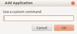

var=$(zenity --entry \
--title="Add Application" \
--text="Use a custom command" \
--width="320")

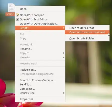

How it looks like
After that when you right click on a file you could see an option Scripts followed by another option under script Open with custom command.
When you select the option Open with custom command, you will get a dialogue box like,
You can write a command in the box to open the file.
