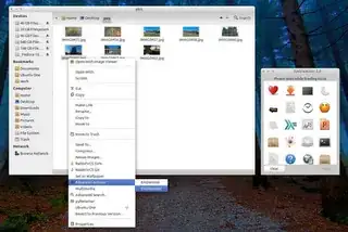

Nautilus Actions Extra provides a set of useful scripts for Nautilus 3. Among the included scripts/actions are: advanced search, open file with Gedit as user or root, set image as wallpaper, mount or unmount ISO files, verify checksum, convert image and audio files, batch rename (pyRenamer), add emblems and more.
nautilus-action
be aware that it will install a lot of dependencies which are required by the various scripts it comes with.
To install Nautilus Actions Extra in Ubuntu 11.10 or 12.04, use the commands below:
sudo add-apt-repository ppa:dr3mro/nautilus-actions-extra
sudo apt-get update
sudo apt-get install nautilus-actions-extra
and restart nautilus using nautilus -q or logout and re-login.
To launch Nautilus Actions Configuration Tool(to edit actions list) as root:
gksu nautilus-actions-config-tool
