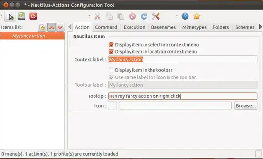

Possible if you use Nautilus-Action. You may define your own right-click context menu items with this package. There is no need to store scripts in the ~/.gnome2/scripts folder.Instead you can use the same script with Nautilus-Actions-Configuration Tool.
sudo apt-get install nautilus-actions

Since most of the nautilus-scripts are basically Shell-scripts or Python-scripts (or Perl scripts) it is easy to convert them to nautilus-action scripts.
