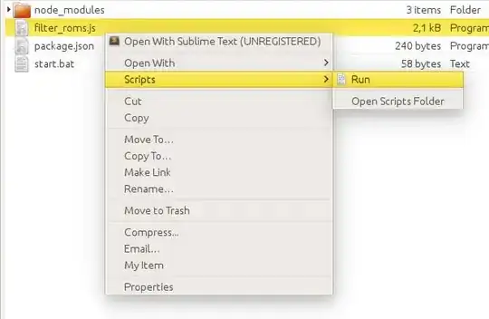

Well at first I looked into nautilus-python as suggested here. However the sparse documentation left me unsatisfied with being unable figure out how to determine position within the context menu and setting a context (file/mime type).
I ended up with going with a custom script as suggested here.
Creating this file:
~/.local/share/nautilus/scripts/Run
#!/bin/sh
eval "./$1"
Make it executable with chmod +x ~/.local/share/nautilus/scripts/Run
Result: enter image description here
I'm sure you know how to improve this so please comment!
