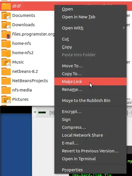

I finally got round to studying and understanding hard links in my quest to check I have understood the basics, of which I have managed to skip a lot of. After realizing how brilliant they are, I wonder why there isn't better support for them in Ubuntu's default file manager, nautilus.
At the moment, there is only one option for creating a link to a file, and it will create a "soft" link.
The trouble with this is that they break as soon as you move or rename the original file.
Question
Is there a way to get nautilus to create a hard link, or some sort of addon/script/configuration/tweak I can do to add the option in the right-click menu, or a keyboard shortcut, to create a hard link for a file?

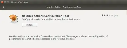

1. First install the package nautilus-actions:
sudo apt update
sudo apt install nautilus-actions
Or use Ubuntu Software:

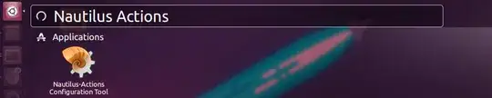

2. Run the program:
run nautilus-actions

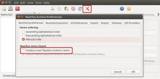

3. Go to 'Preferences' and uncheck 'Create root Nautilus Action menu':
nautilus-actions Preferences
When this option is ticked, in the context menu will have sub menu, etc.

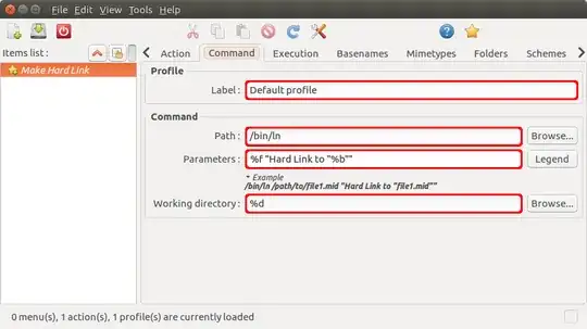

5. Go to Command tab and fill the parameters:
  • Profile:
  • Label: Default profile - if there is no any custom profile.
  • Command:
  • Path: /bin/ln - this is path to the executable file (or command).
  • Parameters: %f "Hard Link to "%b"" - click on Legend button for more info.
  • Working directory: %d - means current directory.
Define new action - Command

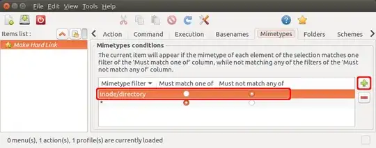

6. Because Directory hardlinks break the filesystem in multiple ways we must disable this possibility. Go to Mimetypes tab and add a new rule:
  • Mimetype filter: inode/directory,
  • with Must not match any of option selected.
Define new action - Mimetypes

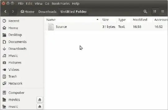

8. Run Nautilus and use Make Hard Link action from the context menu:

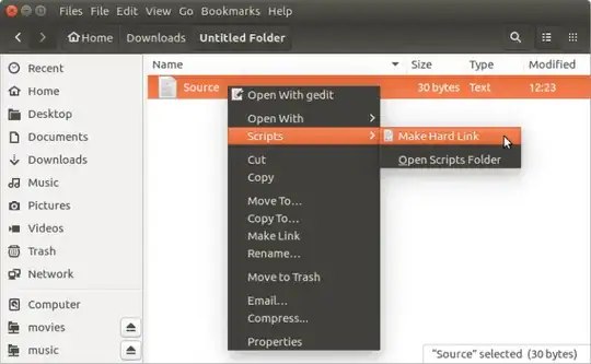

Solution 2: by using Nautilus Scripts
The same result can be achieved via a script, placed into $HOME/.local/share/nautilus/scripts/. This script could looks like:
$ cat "$HOME/.local/share/nautilus/scripts/Make Hard Link"
#!/bin/bash
if [[ -f "$1" ]]
then
        ln "$1" "Hard Link to $1"
fi
We can create this script and give to it executable permissions via the command:
ScriptNAME="$HOME/.local/share/nautilus/scripts/Make Hard Link" && \
printf '#!/bin/bash\nif [[ -f \"$1\" ]]\nthen\n\tln \"$1\" \"Hard Link to $1\"\nfi\n' |\
tee "$ScriptNAME" && chmod +x "$ScriptNAME"
The result will be:
