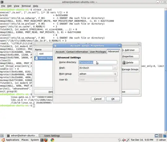

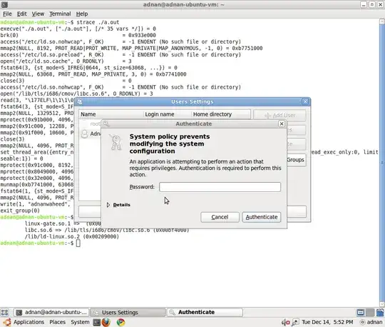

If you want to just move your home directory i.e /home/your-username then simply copy your home directory to other partition and then use System->Administration->Users & Groups to open user settings dialog. Click on the keys icon to authenticate your self
alt text
After that select the user that you want to change and click properties, go to advanced tab
alt text
change the home directory to new directory i.e the directory that you copied to other partition.

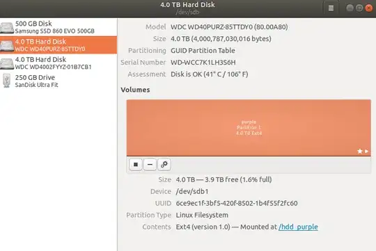

  • Check availability and format two HDDs: "WD Purple" and "WD Gold".
  • Mount two HDDs to Ubuntu file system.
  • Move HOME folder to "WD Gold" HDD.
Related links:
Format disks
Plugin all necessary SATA and power cables to your HDDs. Load Ubuntu. Press keyboard and type "Disks". "Disks" utility will be opened: enter image description here
In this utility you could format your HDDs into Ext4 file system. Otherwise to format disks use commands:
  1. fdisk (man fdisk);
  2. parted (man parted);
  3. mkfs (man mkfs)
For example, but I'm not sure with parameters because used GUI "Disks":
sudo mkfs.ext4 -L purple /dev/sdb  # not sure with parameters
sudo mkfs.ext4 -L gold   /dev/sdc  # not sure with parameters
Keep in mind, that formatting will delete everything on target hard disk. You can skip this step if there are any data on the hard disk and you want to not lose it.
Slow formatting should take a lot of time: from 16 up to 20 hours for 4TB disk.
