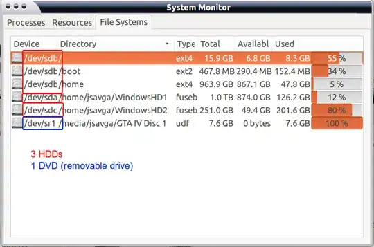

The simplest way is to open the System Monitor by clicking the dash icon (top left) and entering System Monitor as the search. When it opens, click the File Systems tab and it will show you where everything is placed.
/dev stands for device. HDDs will normally be named SDA, SDB, SDC, etc.
The above shows 3 HDDs and 1 DVD rom. My linux installation is on HDD "b" (Hence, dev/sdb) and includes 3 partitions, one for Root "/dev/sdb/", one for boot "/dev/sdb/boot" and one for home "/dev/sdb/home".

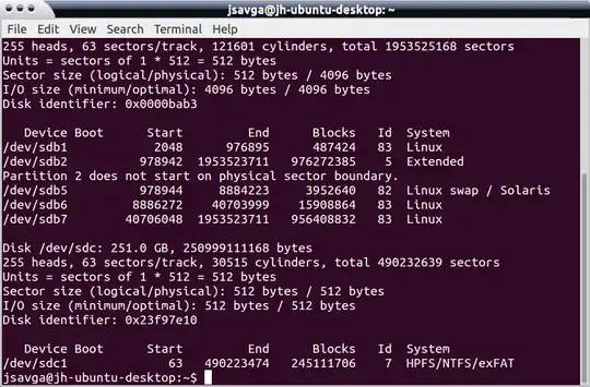

A second way of determining would be to use fdisk. Open a terminal (Press ControlAltT), enter sudo fdisk -l and input your password when prompted. It will output your drives and how they are configured.
