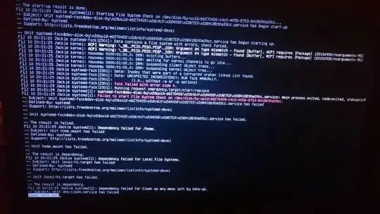

I need help with a fresh Ubuntu 16.04 install. The installation went without any problem. After it, I moved my /home directory to larger disk. Ubuntu was installed onto small 24 Gb SSD. I moved /home according to this manual Move home folder to second drive. Everything went smoothly, I was able to login and it worked(I rebooted it, shut it down and turned it on again) ok for a day. But after one of the reboots my system booted into an emergency mode. Rebooting obviously didn't help.
I executed journalctl -xb to get logs. Here is a picture: enter image description here

Edit 2: running sudo fsck /dev/sda1 fixed all my problems. Thank you

You should be able to repair things by using a Live Media to repair the /etc/fstab entry that points to /home, so it references the correct volume.
