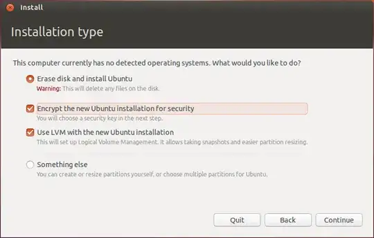

Install Ubuntu 18.04 LTS onto your smaller (usually the SSD) and check (i) erase the disk, (ii) encrypt the installation, and (iii) LVM management.
screenshot of install choices
This will result in an encrypted SSD, but will not touch the second (usually HDD) drive. I'm assuming that your second drive is a new, unformatted drive, but it doesn't really matter what's on the drive prior to this procedure. We are going to destroy all the data on this drive. We are going to use a software package from within Ubuntu to prep the drive (not sure whether or not this preparation is strictly necessary, but it's what I've tested). To prepare this for your soon-to-be moved /home partition (folder), you should format it using the GUI tool called gParted.
