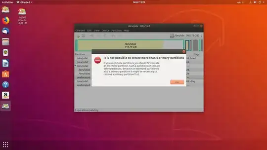

I am using ubuntu 18.04 in a dual boot system with windows 10 and while installing, I did not make a home partition but left around 20 GB for it if I ever changed my mind. However due to an error I had recently with the linux modules, I realized how dangerous it is to keep important files in the root partition and how easy it is to corrupt system files.

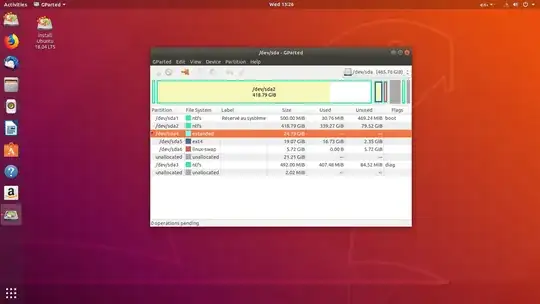

I just opened GParted using a live USB and turned swap off. enter image description here When clicking on the unallocated space and pressing the add button, it tells me there are already 4 primary partitions. enter image description here But I just want to add a partition to the extended partition not make a primary one. Help please!

Ok, I solved it by resizing the extended partition first and then pressing the unallocated space in there and clicking add.
