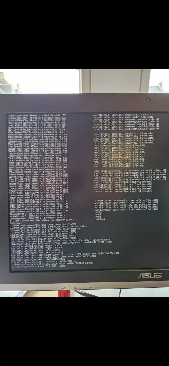

I made a fresh installation of Ubuntu 24.04 on an Asus all-in-one. Everything was working as it should, but after the first update, it suddenly wouldn't boot into Ubuntu anymore.
I thought a recovery USB could solve it, but it won't start up. So I wanted to start over with a new Ubuntu installation, but it won't boot the USB either.
At startup, the screen freezes shortly after this message:
Frozen Screen Error message
Then I realized it probably has Nvidia... Ugh... That's an area I'm not strong in...

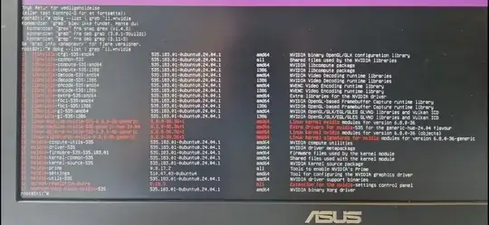

So I went through Grub to a command screen. Here I ran a dpkg --list | grep ^ii.*nvidia and got the following response: enter image description here
Is there anyone who can help me move forward from here?

When booting the original rig, might this just be failing to display the Plymouth screen? (Plymouth screen is the splash during boot.) If so you could disable this from the grub boot.
If you do not see the grub menu when booting then follow the instructions in the following: -
How to get to the GRUB menu at boot-time?
This link is a bit old but probably will still work.
Having entered the grub menu you select the Ubuntu entry and edit it as described in the following: -
How do deactivate plymouth boot screen?
Removing quiet as well as splash will additionally include booting debugging data.
...extra...
There are other combinations that might be worth exploring. Firstly, change 'splash' to 'nosplash' which isn't the same as just removing 'splash'. Another is adding the flag 'nomodeset'. In order to give high quality graphics during the boot process the graphics configuration (in the past) was moved to the beginning of the boot process. This flag will delay the kernel to not start video drivers until the system is up and running.
What do the nomodeset, quiet and splash kernel parameters mean?
(Please try to add some feedback.)
