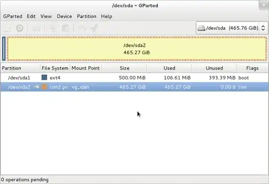

I want to shrink my second (LVM) partition, in order to create a new partition in the newly freed space. I am using the Live CD to do so, because I know I can't resize/move this partition while it is in use. When I opened GParted in the Live CD, I realized that I could not resize the partition, because when I right-click it, the option "resize/move" is disabled.
I tried to unmount it, to "lazy" unmount it (umount -l /dev/sda2) but it didn't work.
A screenshot from GParted:
GParted screenshot

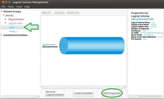

You can shrink/extend a logical volume very easily with a GUI tool: system-config-lvm. Because system-config-lvm does not come pre-installed, once booted from a live-cd, you have to install it:
sudo add-apt-repository "deb http://archive.ubuntu.com/ubuntu $(lsb_release -sc) universe"
sudo apt-get update
sudo apt-get install system-config-lvm
Once it is installed, run the program, select the logical volume you want to change in the left panel, click 'Edit Properties'.

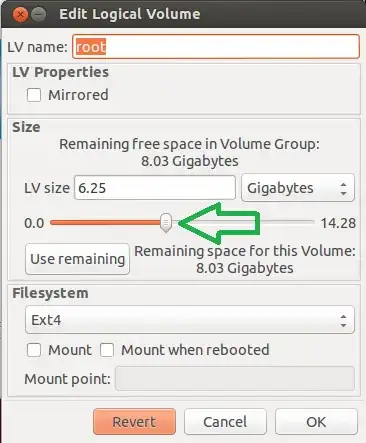

Now change the parameters as you wish!
Edit Logical Volume window
One good thing about system-config-lvm is that it won't allow you to go ahead if the new partition size is smaller than all your existing data combined (I've just tried this and seen for myself).

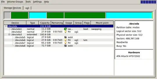

Only the latest version of Gparted (0.14) supports resizing LVM physical volumes. The version that ships with Ubuntu 12.10 or 13.04 does not support it.
Here's how to resize an LVM physical volume:
  1. If the volume group associated with the LVM physical volume does not have enough unallocated space, you'll need to make some by shrinking a logical volume. Look at bigbadonk420's answer for instructions on how to do that. You can also use GNOME Disks (included with Ubuntu) for some of the steps if you prefer a GUI.
  2. Burn the latest .iso image from GParted's website, and burn it on a CD or put it on a USB stick. Boot from the CD or the USB stick. Alternatively, you could compile the latest version of GParted from source.
  3. Use GParted to resize the LVM physical volume. GParted won't let you shrink the LVM physical volume to a size smaller than what the unallocated space allows.
