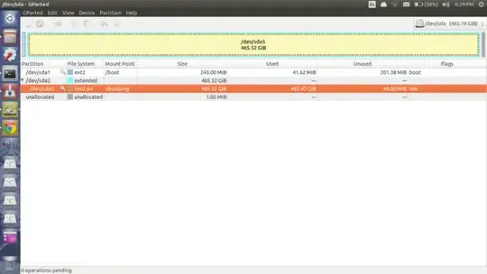

I wanted to install ubuntu alongside windows but it formatted the disk completely, now I want to install windows alongside ubuntu, above is the link to present status of harddisk (gparted)
Please help me how to resize the partition and install windows, I am a complete newbie to linux/ubuntu as such.

You have an tutorial here : http://www.howtogeek.com/114503/how-to-resize-your-ubuntu-partitions/ , did you try ?
Be carreful, nou need boot to live CD/USB
Else, you can try this : How can I resize an LVM partition? (i.e: physical volume)
