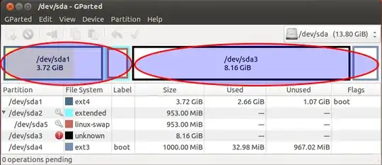

  2. Create two partitions using GParted included in the live disk. The first partition should be unformatted and should be large enough for root and swap, in my example, this is /dev/sda3. The second partition should be several hundred megabytes big and formatted in ext2 or ext3, it will be unencrypted and mounted to /boot (in my example this is /dev/sda4).
    In this screenshot, I have an existing unencrypted Ubuntu installation in two partitions: /dev/sda1 and /dev/sda5, highlight in the circle to the left. I have created an unformatted partition in /dev/sda3 and an ext3 partition in /dev/sda4, intended for the encrypted Ubuntu installation, higlighted in the circle to the right:
    GParted screenshot

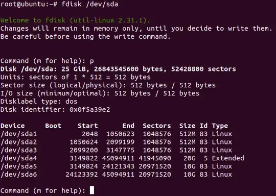

  2. fdisk /dev/sda, then, create the following partitions
    • enter image description here

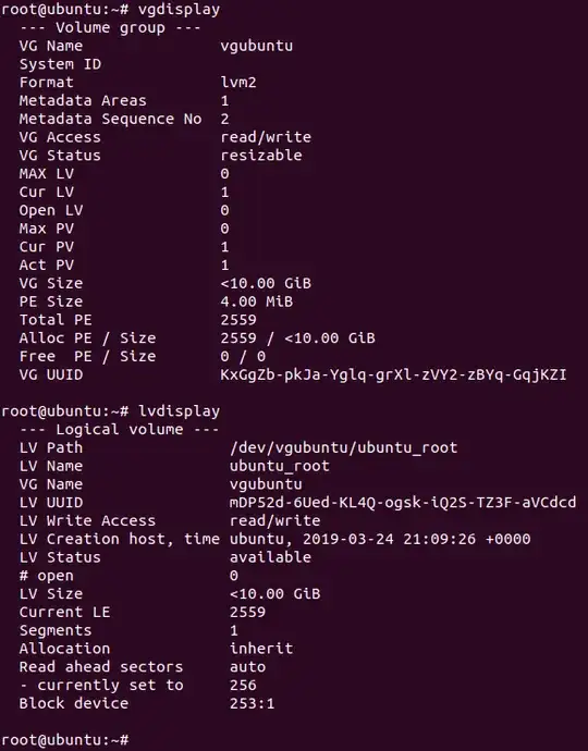

  5. pvcreate /dev/mapper/sda5_crypt
  6. vgcreate vgubuntu /dev/mapper/sda5_crypt
  7. lvcreate -L10G -n ubuntu_root vgubuntu
    • lvcreate -l 100%FREE -n ubuntu_root vgubuntu (optional, instead of running lvcreate -L10G -n ubuntu_root vgubuntu, you can run this lvcreate -l 100%FREE -n ubuntu_root vgubuntu to use your whole disk free space, instead of only 10GB)

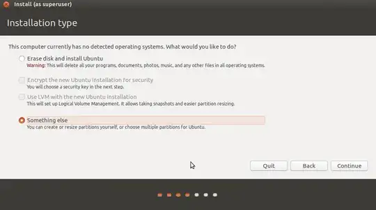

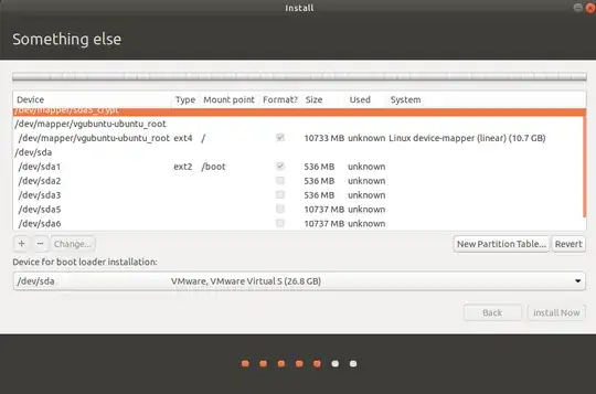

  8. Do not close the terminal, and open the distro installer, select Something else and mark the following options
    • /dev/sda1 mounted as /boot partition with ext2 format
    • /dev/mapper/vgubuntu-ubuntu_root mounted as / with ext4 format.
    • /dev/sda as boot loader installation
    • Do not mark anything else
  9. Select Install Now after selecting the above options

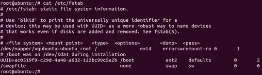

  21. echo sda5_crypt UUID=5f22073b-b4ab-4a95-85bb-130c9d3b24e4 none luks > /etc/crypttab

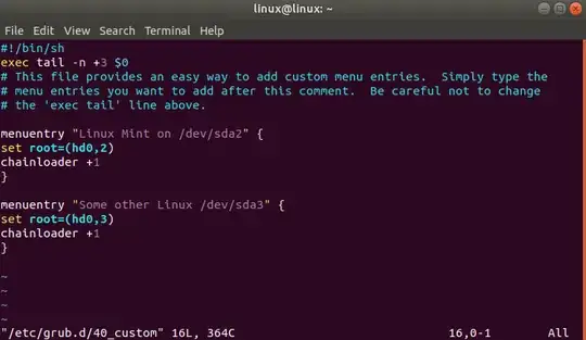

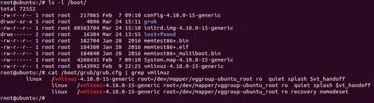

  22. Create the file /etc/grub.d/40_custom

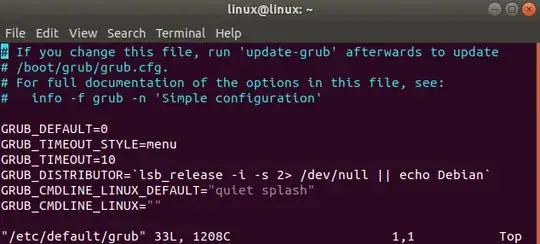

  23. Edit /etc/default/grub and set
    • GRUB_TIMEOUT_STYLE=menu
    • GRUB_TIMEOUT=10

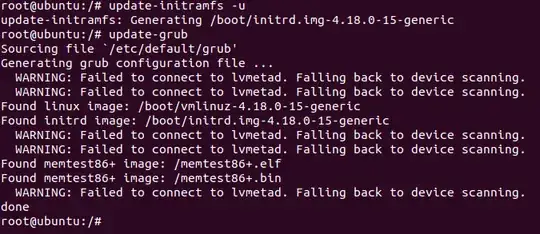

  24. update-initramfs -u
  25. update-grub

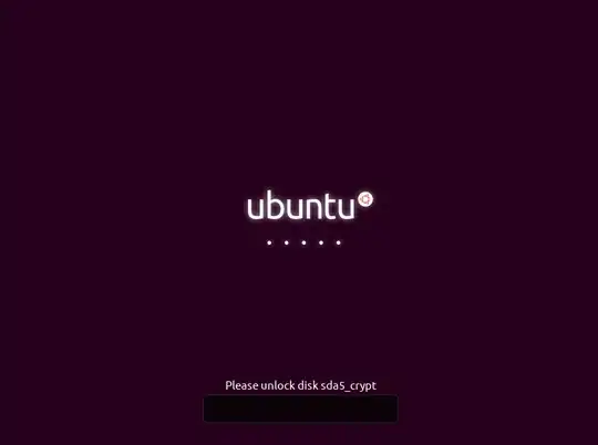

  28. After rebooting your computer, select the option Ubuntu and it will correctly ask for your encryption password

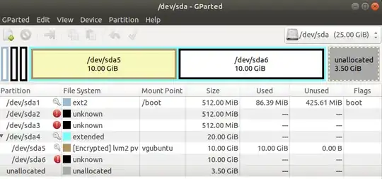

  30. And by opening gparted you will find this

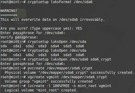

  1. sudo su -
  2. cryptsetup luksFormat /dev/sda6
  3. cryptsetup luksOpen /dev/sda6 sda6_crypt
  4. pvcreate /dev/mapper/sda6_crypt
  5. vgcreate vgmint /dev/mapper/sda6_crypt

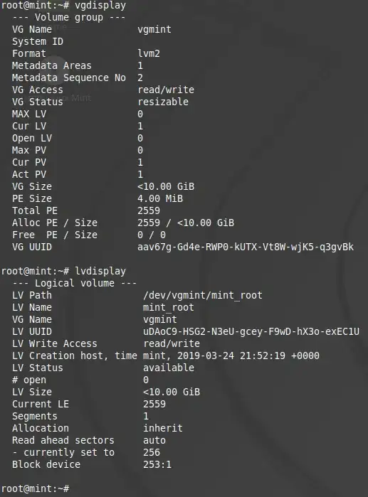

  6. lvcreate -L10G -n mint_root vgmint
    • lvcreate -l 100%FREE -n mint_root vgmint (optional, instead of running lvcreate -L10G -n mint_root vgmint, you can run this lvcreate -l 100%FREE -n mint_root vgmint to use you whole disk free space, instead of only 10GB)

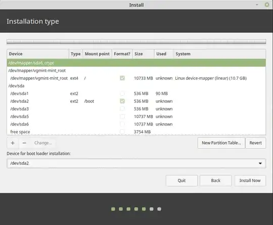

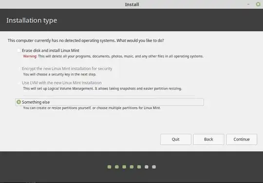

  7. Do not close the terminal, and open the distro installer, select Something else and mark the following options
    • /dev/sda2 mounted as /boot partition with ext2 format
    • /dev/mapper/vgmint-mint_root mounted as / with ext4 format.
    • /dev/sda2 as boot loader installation (do not select /dev/sda as before)
  8. Select Install Now after selecting the above options

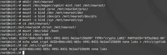

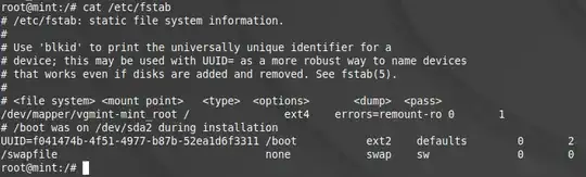

  19. blkid /dev/sda6 (copy UUID without quotes and use it on the next step)
  20. echo sda6_crypt UUID=5f22073b-b4ab-4a95-85bb-130c9d3b24e4 none luks > /etc/crypttab

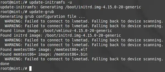

  21. update-initramfs -u
  22. update-grub

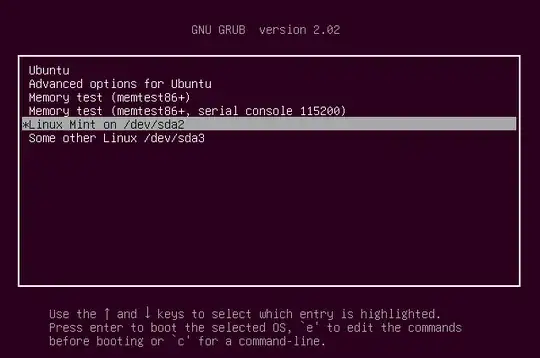

  25. After rebooting your computer, select the option Linux Mint on /dev/sda2

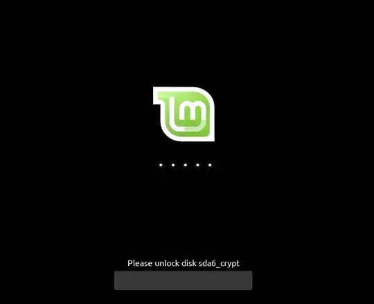

  26. Then, it will correctly start Mint 19.1 and asked for the encryption password
