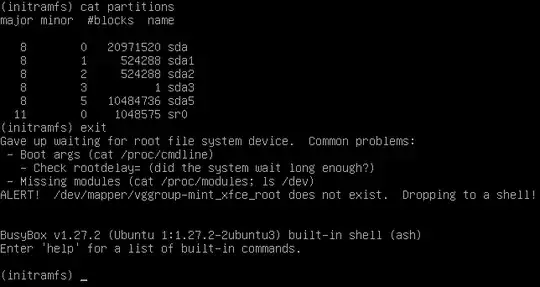

After following all steps to install the first Linux, and rebooting the machine, I got into the Boot drops to a (initramfs) prompts/busybox with this error:

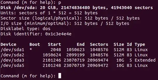

  1. fdisk /dev/sda, then, created the following partitions:
    • enter image description here

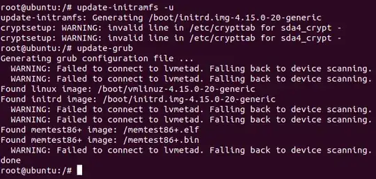

  18. update-initramfs -u
  19. update-grub
