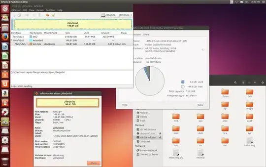

I saw later that there is something wrong in the partition and disk use. In Gparted the whole disk is used, but not in real life(se picture)
I am no able to resize the partitions and have no clue what to do.

the image below shows the disk situation

Your partition is lvm, this is why it is marked as fully used. As far as I know, GParted doesn't work to manage lvm partitions yet. You need to use the lvm tools (pvs, lvs, lvdisplay, lvcreate and so on), parted in terminal (not sure if it works, as I never tried) or fdisk to work with lvm partitions.

There's nothing wrong with your disk, and you've presented no evidence that a disk problem is causing your sluggish performance. As laurent says, GParted doesn't give you free-space estimates on LVM.

You all are right, I have made a fresh reinstall and did not thick off on LVM. Repartitioned my disk, with no apparent perfomance result.
