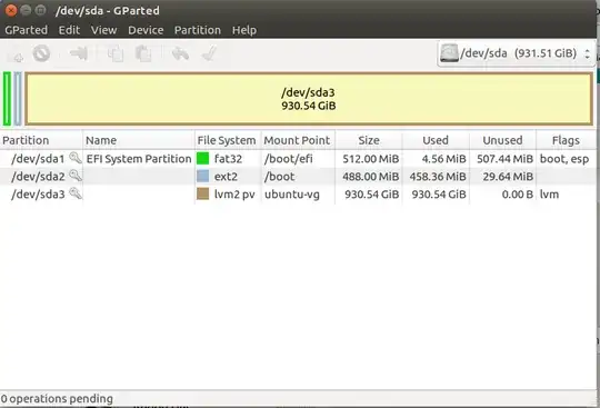

I am trying to increase by /boot as it has reduced the capacity to install new updates. The partition details are given below:
Please suggest me a way to increase the /boot partition to atleast 1GB

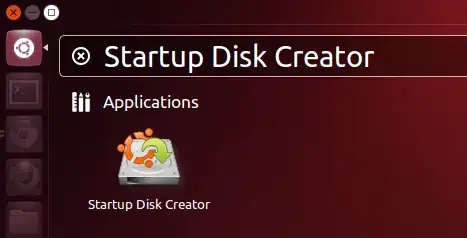

  2. press windows key or Launch the Startup Disk Creator from the application menu/Dash Startup Disk Creator
or run the following command in the terminal (Ctrl+Alt+t):
usb-creator-gtk

  6. Shrink your 3rd partition and then merge the unallocated space into your /boot.
