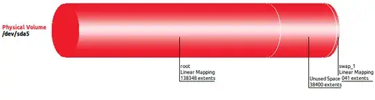

But Now I have the hard part.
Now I need to shrink the Physical Partition down so I can create a new Physical partition with the space to install Windows 8.
So I thought I could run
pvresize --setphysicalvolumesize {any size here} /dev/sda5
But I get back:
/dev/sda5: cannot resize to xxxxx extents as later ones are allocated.
Which I believe is due to the swap due to this image:
Darn Swap!, so what's my next step?

These are all the steps required to resize a LVM or LVM2 partition -
sudo lvresize --verbose --resizefs -L -150G /dev/ubuntu/root
sudo pvresize --setphysicalvolumesize {any size here} /dev/sda5
You have to rearrange the unallocated space at the end of the LVM. That means after root and swap_1 partition. So, you need to move that free space using the command below
pvs -v --segments /dev/sda5
This will show the output like below
/dev/sda5 ubuntu lvm2 a-- 698.04g 150g 0 xxx root 0 linear /dev/sda:0-xxx
/dev/sda5 ubuntu lvm2 a-- 698.04g 150g xxx nnn 0 free
/dev/sda5 ubuntu lvm2 a-- 698.04g 150g yyy zzz swap 0 linear /dev/sda5:yyy-zzz
Now use the command below to remove external fragmentation -
sudo pvmove --alloc anywhere /dev/sda5:yyy-zzz
Now let us see how it goes -
/dev/sda5 ubuntu lvm2 a-- 698.04g 150g xxx nnn swap 0 linear /dev/sda5:xxx-yyy(-1)
/dev/sda5 ubuntu lvm2 a-- 698.04g 150g yyy zzz 0 free
After that use the gparted and resize the LVM to maximum used area and rest will be in unallocated space. Enjoy...

I'd, now that you've got the smaller root LV, lvremove the swap LV and recreate it. This should force it to be directly appended to the root LV in terms of position. Once that is done you should be able to pvresize the physical volume. Then it's the scary part in editing the partition table (fdisk) to downsize the partition to the PV's new size, thereby freeing up space for the Windows installer to use.
For the downsizing of the partition I'd recommend to go slightly larger, by a few MB, than the PV reports it's size as and upsize the PV and root LV to fill the free extents. That way you can be sure you're A) using all of the partition's size for LVM and not losing space by making it inaccessible, and B) not cutting off vital data from the PV by misinterpreting binary KiB/MiB/GiB for decimal KB/MB/GB or vice versa during the fdisk operation.
The new swap, if you create a new one to ensure it's appended to the root LV as I suggest above, will have a different UUID and therefore your /etc/fstab will not match. Once the resizing is all finished, you will need to mount /dev/ubuntu/root /mnt edit /mnt**/etc/fstab**.
