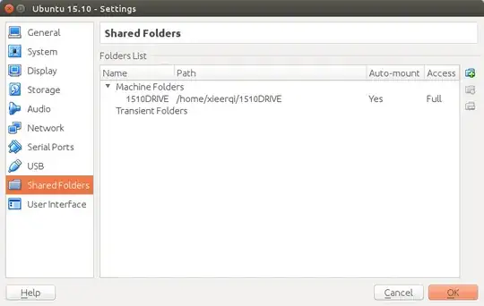

First , if you need to edit same file in both Windows and Ubuntu VM, you need to have a shared folder between virtual machine and the host OS. With VirtualBox, you will need to set that up in Settings -> Shared Folders.
In addition to that, I suggest you add your user on virtual machine to vboxsf group. Use sudo usermod -a -G vboxsf username for that
