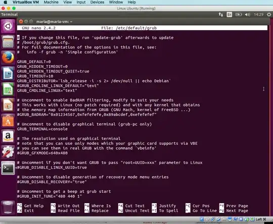

My /etc/default/grub is as follows - see image - but the VM is booting into the GUI. Why?

The myth of the text kernel parameter
It has passed around as system administrator folklore over the past few years that there's a standard kernel parameter for Linux, specificable from whatever boot loader one is using, by the name of text; and that specifying that parameter at bootstrap time ensures that the system comes up in multi-user mode with networking but without the graphical user interface — what on some systems with System 5 init used to be a distinct run level that one could choose at bootstrap time.
"If you are using GRUB", say hundreds of web logs, tutorials, discussion fora postings, and even Stack Exchange answers such as this one and this one and this one; "then you specify the text kernel parameter by adding it to the contents of the GRUB_CMDLINE_LINUX_DEFAULT setting in /etc/default/grub, or you just edit the kernel command line interactively from the GRUB menu and add text there."
This is not a widely used kernel parameter. It's a bodge that only works —
- on Ubuntu Linux, with GDM, when upstart is in charge of system services;
- on Debian Linux, with GDM, when System V
rcis in charge of system services.
This is because it's a piece of shell script that checks every word on the kernel parameter list looking for one that reads text or s or single. On Ubuntu Linux it lives in the upstart job unit for GDM. On Debian Linux it lives in the old System V rc script for GDM. It's not a part of GDM proper. Nor is it a general convention.
People have already, long since (as in this 2011 AskUbuntu answer for just one example), spotted that Ubuntu with LightDM or KDM instead of GDM didn't obey this parameter. A similar upstart job file bodge was added for LightDM. With the switch from upstart to systemd in version 15, people are spotting, as you have, that this now doesn't work at all.
It's time to consign this bodge to the dustbin of history. Run levels have been a backwards compatibility measure on Ubuntu Linux for almost a decade, now. And that's for the system manager before the current default one. systemd doco actually explicitly describes them as "obsolete". They aren't the way to think about things. Ironically, "single-user mode" has been obsolete for far longer, almost twice as long indeed. It was superseded by a split "rescue mode" and "emergency mode" model in the middle 1990s when init gained its -b option.
The-bswitch will be passed through LILO toinitand will cause an emergency boot [...]
— David A. Bandel (1997-01-01). Disk Maintenance under Linux.. Linux Journal.
There's even more detail on the sorry tale of this bodge in Ubuntu bug #436936.

If I can understand you well, you want to simply boot to a non-graphical (console) interface by default
You can simply run the following commands. I ran them in VM (15.10) minutes ago and it worked well:
