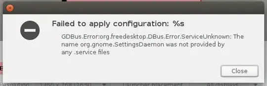

But the Unity Desktop I get is still not usable. It has a screen resolution of 800x600 and all indicators are missing, the panel is completely empty. Also I can't change the settings (e.g. the display resolution), which results in an error like this:
screenshot: Failed to apply configuration
I'm opening a new question on this:
Unity Desktop incomplete when launching manually using 'startx $(which unity)'
