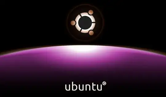

Ubuntu Sunrise (plymouth)
I use an old favorite "Ubuntu Sunrise" in 12.04 (In fact I have been using it since 10.04 LTS). It's easy to install (instructions below) and it has never caused me any issues. However you should note that changing your Plymouth may cause resolution issues depending on your own resolution.
Ubuntu Sunrise
INSTALLATION INSTRUCTIONS
Step 1:
Download the Plymouth Sunrise deb file from here.
Step 2:
Open the Terminal (Ctrl-Alt-T) and type
gksudo nautilus
Step 3
  • Copy ubuntu-sunrise folder to /lib/plymouth/themes
  • Copy the file splash into /etc/initramfs-tools/conf.d (Optional, for better buffer)
Step 4:
Type in the terminal
sudo update-alternatives --install /lib/plymouth/themes/default.plymouth default.plymouth /lib/plymouth/themes/ubuntu-sunrise/ubuntu-sunrise.plymouth 200
sudo update-alternatives --config default.plymouth
Step 5:
Choose the number associated with ubuntu-sunrise in the options that pop up.
Step 6
sudo update-initramfs -u
Then
sudo reboot
That's it.
Note: Some people have issues installing other Plymouth themes (I've never had any) and I would strongly advise you to take a look at these issues here at Ask Ubuntu to familiarise yourself.
