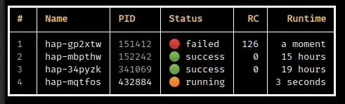

The modern and easy to use approach that allows managing multiple processes and has a nice terminal UI is hapless utility.
Install with pip install hapless (or python3 -m pip install hapless) and just run
$ hap run my-command  # e.g. hap run python my_long_running_script.py
$ hap status  # check all the launched processes
See docs for more info.
ui
NOTE: I'm the author of this package.
