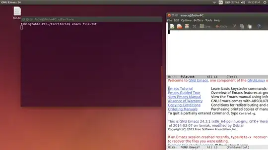

I open a file with emacs through terminal just typing
emacs file.txt
and when I close terminal, emacs closes too, and when I try to execute another thing terminal doesn't let me becuase keeps like this:
how can I solve this?
emacs file.txt
If you really need a terminal to run emacs, the use the command below
emacs file.txt & nohup
From man nohup
nohup -
run a command immune to hangups, with output to a non-tty
In addition to previous method you can use setsid:
setsid emacs file.txt
man setsid
setsid - run a program in a new session
