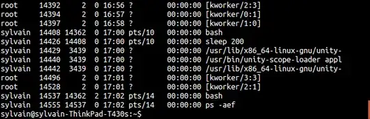

You can now close the terminal, the process will still be alive. You can open another terminal and check its process id with ps -aef
In my case the process id is 14426. Unfortunately there's no easy way to reattach it to another terminal (See How to attach terminal to detached process?) unless you used something based on screen.
