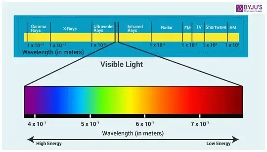

The chart below shows the different energy frequencies of both the visible spectrum and the larger electromagnetic scale from radiation to radio waves.
Source: https://byjus.com/physics/visible-light/
The ongoing question is that we can observe that those electromagnetic and light-speed phenomena are effected by various physical objects and, albeit in the most extreme circumstances, “The Weak Force” (Gravity). Since we observe this, we suppose that light and energy have features that would imply a “tangible particle” traveling on a path. Thus we currently treat light theoretically as a “particle” and a “wave” simultaneously while it would seem incongruous. To my knowledge, the “Matter composition” of a photon is yet to be established beyond some of its observed characteristics. I believe this is one of the current issues at heart of the unestablished theory to align “Quantum Mechanics” (the rules governing physics at the subatomic level, of which a photon particle would be classified as) and “General Relativity”.
