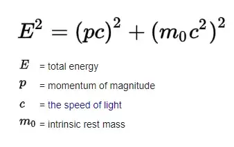

If $E=pc$ for massless particles, then it should be $p=0$ as $p=mv$ and $m=0$. Why do we use the equation $E=pc$ for massless particles?

The momentum of a massless particle is not $p=mv$. In special relativity, even for a massive particle, the 3-momentum is not given by mv, but rather
$$p^{a} = \frac{mv^{a}}{\sqrt{1 - \left(\frac{v}{c}\right)^{2}}}$$
The right hand side of this takes an indeterminate value (0/0 division) if $v$ goes to $c$ as $m$ goes to $0$.
All of this is a longwinded way of saying, "for a massless particle, the magnitude of the momentum is equal to the energy divided by $c$.
