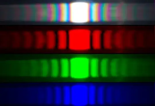

Iow, would the double slit experiment have a different result when performed with 'red photons' instead of 'green photons', and if so, how would it differ ?

Probability waves are are math calculation used to predict the outcome and do not determine anything physically. Yes the double slit experiment would have different results when performed with red photons instead of green photons. enter image description here The higher the energy the shorter the seperation between fringes. In the attached photo you can see that the green fringes are closer together than the red fringes. In the single slit experiment interference comes sooner for the green light than the red light and again the green light has shorter distances between the spacing than the red light.
