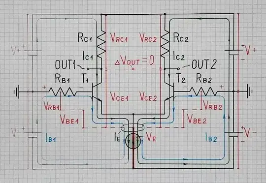

We can see it in the classic differential pair with emitter current sink ("tail"); there is no fundamental difference with op-amp input stages. I have drawn below four pictures of this stage to show in a more attractive way the voltage drops and current paths in all the cases - without and with base resistors included. To make the pictures more beatiful and fully symmetric, I have drawn in the left side, in paler colors, the same supply voltage sources V+ and V-. I hope this will not make it difficult for you.

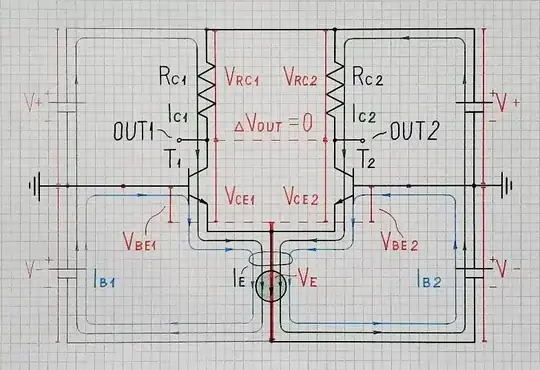

1. Differential pair without RB1 and RB2. Let's first consider the case with zero input voltage sources and with no base resistors included (Fig. 1):
Fig. 1. Differential pair without RB1 and RB2 included (grounded inputs)
As you can see, the negative power supply V- "pulls down" through the emitter sink IE the transistor emitters... and they "go down" under ground with VBE. For proper understanding, it is necessary to realize that IE is not a "source" in the literal sense of the word (ie, an element supplying power) but it is only a "dynamic resistor" that "doses" the power so that a constant current flows. So, the input bias currents IB1 and IB2 are produced by the negative supply V- and determined by the current-stabilizing element IE (the positive source V+ does not participate in the creation of bias currents). What surprises beginners is that they only see bias currents coming out of the ground without seeing where the voltage that creates them is... as though the ground produces them.
The emitter current is split equally between the two transistors and creates equal voltage drops across the two collector resistors. The collector voltages are equal and their difference is zero.
In op-amp input stages (e.g., in 741), more sophisticated circuit structures (common-base stages, current mirrors) stay between the emitters and the negative supply... but the bias current paths are the same.

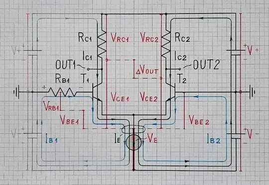

2. Differential pair with RB1. Now let's include a base resistor RB1 (it can be considered as internal resistance of the zero input voltage source VIN1) - Fig. 2:
Fig. 2. Differential pair with RB1 included (grounded input 2)
The input bias current IB1 will "create" a voltage drop ("input voltage") VRB1 across it... and T1 base will "go down" under ground with VRB1. Since T2 base is fixed to zero voltage (grounded), T2 emitter will try to stay "immovable" while T1 "pulls down" it. As a result of this "arm wrestling", VBE1 will decrease and VBE2 will increase. Accordingly, VOUT1 will increase and VOUT2 will decrease... and a differential output voltage dVOUT will appear.

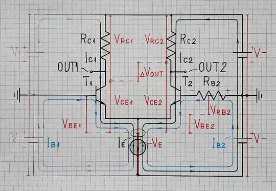

3. Differential pair with RB2. Similarly, if we include a base resistor RB2 (it can be the internal resistance of the zero input voltage source VIN2) - Fig. 3, the input bias current IB2 will "create" a voltage drop ("input voltage") VRB2 across it... and now T2 base will "go down" under ground with VRB2:
Fig. 3. Differential pair with RB2 included (grounded input 1)
Since T1 base is fixed to zero voltage (grounded), T1 emitter will try to stay "immovable" while T2 "pulls down" it. As a result of this "arm wrestling", VBE1 will increase and VBE2 will decrease. Accordingly, VOUT1 will decrease and VOUT2 will increase... and a differential output voltage dVOUT with an opposite polarity will appear again.
4. Differential pair with RB1 and RB2. Finally, let's include both base resistors RB1 and RB2 - Fig. 4:
Fig. 4. Differential pair with RB1 and RB2 included
The input bias currents IB1 and IB2 "create" equal voltage drops ("input voltages") VRB1 and VRB2 across them... and both transistor bases "go down" under ground with VRB1 = VRB2. However, the "dynamic resistor" (aka current sink) IE decreases its resistance to keep the emitter current unchanged... and the emitters also "go down" under bases with VRB1 = VRB2. The emitter current is split equally between the two transistors (as in Fig. 1) and the collector currents create equal voltage drops across the collector resistors. The collector voltages are equal and their difference is zero. The result is the same as in Fig. 1 where both bases were grounded.
So the two voltage drops neutralize each other. This trick (we can name it "passive voltage compensation") is used to compensate the influence of input bias currents.
