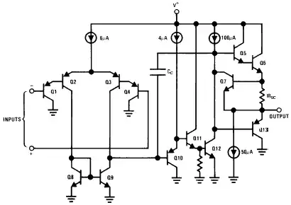

but in proof they put both the voltages at ground and they were still considering input bias current.I'm a little confused that even when there is no voltage at input from where the op-amp is drawing current?
Consider the LM324's equivalent circuit: -
If either input is grounded or taken to the negative rail then current will flow from the base of Q1 and Q4 to the tune of about 45 nA.

  • possible in LM741 too? – well... Jan 10 '20 at 12:17
    @user5841 yes, in every electronic component you've got leakage. and honestly, the 741 is pretty bad in that respect (the 741 is essentially the worst opamp that you can still buy, don't use it in new designs, unless you know exactly that you don't need a good opamp AND are looking to save a few € on a device of which you'll make more than 1000). – Marcus Müller Jan 10 '20 at 12:26
  • In a 741 the input transistors are NPN and so when the inputs are taken to within 2 volts of the most negative rail, the bias currents will decrease but, we only have "equivalent circuits" provided by manufacturers so we can't be absolutely sure that there isn't some silicon inside the 741 that acts as a high but very light pull-up and this will produce a bias current when the input is taken exactly to the most negative power rail. – Andy aka Jan 10 '20 at 12:29
  • http://www.righto.com/2015/10/inside-ubiquitous-741-op-amp-circuits.html – Sredni Vashtar Jan 10 '20 at 12:42
