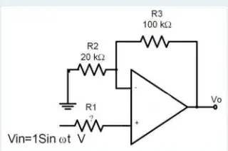

Why do we add R1 in series with the positive terminal for a non-inverting amplifier? What is the best value we can assume or choose for it?

It's to compensate the effect of bias current in the non-inverting amplifier. The compensating resistor value equals the parallel combination of R2 and R3. The input current creates a voltage drop across R1 that offsets the voltage across the combination of R2 and R3.

In the "old times", it was for "impedance reasons" and "symmetry". The simplest value is \$R_2 \parallel R_3\$, so it should be: \$20 \times 100/(100+20) \implies \$ nearest \$16.7 \text{ k}\Omega\$.

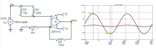

Anyway, be caution with simulators ! Here is a simulation I made with microcap8 or 12 of SpectrumSoftware. Do you see the problem ? It is not the software !
I have also noted that the internal resistance of the generator is not shown. Some OPAs also need a resistance (50 ohm) to ground ... for RF impedance matching. That is not the case here.

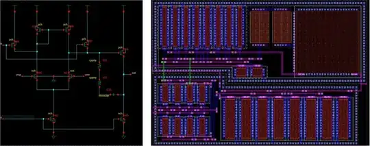

Example of opamp schematic and layout, GLADE VLSI Design https://peardrop.co.uk/

  • However, the topology described is not sufficient in terms of the diagram. It must also be at the level of the final achievement on the chip. Since this is microelectronics, you have to look at the most basic level of realization, and it's not that simple. Let us add the fact that a differential stage is not made up of two transistors but at least four placed in a crossed way! And placed in the 4 corners of a square so that the temperature (outside or inside released by the components themselves) has the least possible influence on the characteristics of the assembly! –  Jun 12 '21 at 08:51
  • Microelectronic technology is an architectural "marvel of ingenuity" in the true sense of the word ... not many people know the difficulty. Remember that a certain current component is like drawing plans for a city to the nearest mm with a square area of 100 km side! Sorry for this long comment ... –  Jun 12 '21 at 08:51
  • Added a picture for explanation beyond this comment. Digital component. –  Jun 12 '21 at 09:05

A compensation resistor is sometimes added in series to the non-inverting terminal of an op-amp when the non-inverting input signal comes from a low impedance source.
Although there are a variety of possible benefits that accrue from the presence of a compensation resistor, they all are related to the idea of balancing the impedance from each of the op-amp inputs to ground.
To achieve such balance, the value of \$R1\$ should be
$$R1 = (R2 || R3) - Rsource$$
Where \$Rsource\$ is the output impedance of the source driving the non-inverting input.

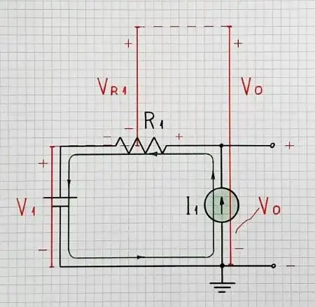

The phenomenon
So, the phenomenon here is that the circuit (op-amp here) produces the input bias currents and passes them via the input circuits to ground. And if we insert some resistance in these paths, voltage drop will appear across them… and it will serve as another input voltage that is connected in series with the genuine input voltage - Fig. 1.

Undesired voltage drop. In some cases, this voltage drop can be undesired. An example is the voltage drop across the equivalent resistance Re = R2||R3 in the OP's non-inverting amplifier.

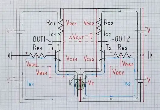

Desired voltage drop. In other cases, it is desired and we intentionally create it by inserting a resistor (R1 in the OPs circuit; RB1, RB2 in Fig. 2 below). We use the fact that the differential amplifier (in the op-amp input stage) has two opposite inputs (inverting and non-inverting) so their voltages are subtracted and if they are equal, the output voltage will be zero.
Differential pair with RB1 and RB2
Fig. 2. Differential pair with RB1 and RB2
Note that both input bias currents are created by the negative power supply V- (not by the emitter current "source").
Voltage compensation. This is a simple but widely used circuit trick. We can name it "passive voltage compensation". There is also a more sophisticated "active voltage compensation" (see my Wikibooks story) based on the negative feedback principle.
