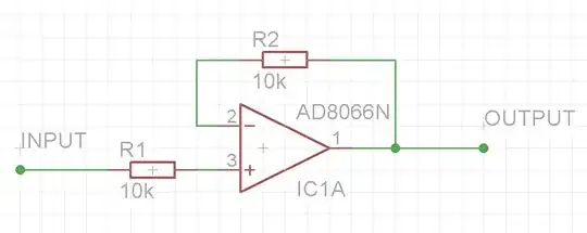

What is the value of Vout if we know the value of Vin in this case?
It is a buffer amplifier, but it has two extra resistors so I think that the gain is smaller than 1, but how small?
(Vin-V3)/R1=0 <=> Vin-V3=0 => Vin=V2=V3
(Vout-V2)/R2=0 <=> Vout-V2=0 => Vout=Vin=V2=V3

With your example and an ideal opamp, it doesn't matter what value the resistors are, or whether they are equal. Since there is no current flowing through either of them, the result is always the same (a gain of 1).
With a real opamp, you have an input bias current (we will ignore the myriad of other non-ideal parameters and just focus on this one), so matching the impedance both inputs see is a good idea (unless there is already internal compensation, which some opamps have - in some cases matching the impedances can make things worse due to the input bias currents being unequal)
So for the example in your question, say we have an input impedance of 1MΩ (a very low value, but some opamps can have very low input impedances, make sure to check the datasheet), we use 10kΩ for the input resistor, but no resistor in the feedback loop. We will choose an input voltage of 1V.
We now get an input current of 1V / 1MΩ = 1uA.
So we now have a voltage drop across the input resistor of 1uA * 10kΩ = 10mV, which is present at the output (which will be 990mV) instead of 1V
If we want to prevent this, we need to match the voltage drop in the feedback loop to cancel out the offset caused by the input bias currents. So we use 10kΩ for the feedback resistor, it drops 10mV too so output is now 1V again.

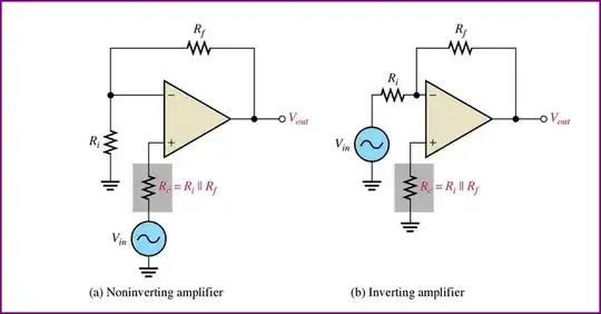

Here's an example of matching the parallel combination of the feedback resistors when you have some gain:
Opamp Bias Current Compensation
This app note from Analog Devices is worth a read for more in depth discussion.

For an ideal op-amp, the following analysis holds. For a practical answer you will need to simulate your circuit using something like LTSpice.
(Input - V3) / R1 = 0, (op-amps have infinite input impedance)
(Output - V2) / R2 = 0, (op-amps have infinite input impedance)
V2 = V3 (op-amps work to mantain Zero potential difference between their inputs when configured for negative feedback is in this circuit)
I have explained the important aspects of an op-amp for solving this problem. I leave the substitution and result for you to find.

    Bingo. Notice that would not be the case if R1 != R2. – NickHalden Jan 05 '13 at 12:42
  • That's good to know! But what changes if R1 != R2 ? – Cristi Jan 05 '13 at 12:48
  • ...Look at the equations I wrote. I left them in terms of R1 and R2 specifically so I would not have to answer that question. – NickHalden Jan 05 '13 at 12:50
  • Assuming R1>0 and R2>0, the result is the same for any values of R1 and R2, because: (Vin-V3)/R1=0 <=> Vin-V3=0 (R1 changes nothing). Same thing for the second relation... – Cristi Jan 05 '13 at 12:56
    Ugh, right you are. I can't think straight right now. – NickHalden Jan 05 '13 at 12:59
  • The point of this problem is finding out if there is negative feedback, in which case that thing behaves as a buffer. Stating V2=V3 is not always true, even for ideal op amps. – Vladimir Cravero Jan 05 '13 at 13:28
    No, opamps do NOT "work to maintain 0 potential difference between their inputs". All they do is multiply the difference between the two inputs times a large value at put that on the output. In some circuits, feedback may be employed for the result you state, but getting that behavior is not inherent to the opamp itself. There are plenty of opamp circuits where your statement is not true. – Olin Lathrop Jan 05 '13 at 14:03
