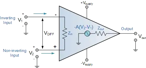

Yes,i have seen all those similar questions of this topic and I am still confused about few concepts.So far i have been taught that an simplified OP-AMP circuit looks like this-------------- enter image description here
So,thinking about input bias current in that circuit here are some confusions-------
1)In a Youtube video i was told that input bias current enters/leaves from both inverting and non-inverting terminal at the same time...and they are equal,How?
