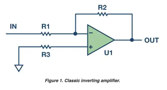

  2. In the diagram, when there exists a potential difference between \$ V_- \$ and \$ V_+ \$ then an \$ I_{OUT} \$ will be generated to zero out the input potential through \$ R_2 \$ and \$ R_1 \$ voltage divider. \$ V_+ \$ is grounded to 0V regardless of the size of \$ R_3 \$. And seeing from the op amp circuitry, the inverting input's emitter sees \$ {R_2 \parallel R_1} \over \beta \$, and the non-inverting input's collector sees \$ {R_3} \over \beta \$. So the op amp behind the inputs sees a total resistance of \$ {R_2 \parallel R_1 + R_3} \over \beta \$. Adding the compensating \$ R_3 \$ only adds to the resistance seeing from the op amp, how is it balancing or compensating anything?

  • V+ is not connected to the ground, it would be true if there would not be any current flowing through there. V+ is connected to R3*I_bias volts of potential. – muyustan May 28 '20 at 01:13
  • @muyustan you're right let me strike that out. But question somewhat remains or if I term it differently: a current in collector-emitter side generates or pulls $ I_c \over \beta $ current into the base after the voltage drop over $ R_3 $. So the size of $ R_3 $ only changes its own voltage drop but current into + (or base of a BJT) remains a value dictated by its collector current inside the op amp. Wow this is confusing - a collector current induces a base current?? – KMC May 28 '20 at 01:59
  • see here https://electronics.stackexchange.com/questions/320300/current-return-path-when-using-an-ac-coupled-transimpedance-amplifier/320387#320387 – G36 May 28 '20 at 03:30
  • And with the compensating resistor https://i.stack.imgur.com/FbltQ.jpg – G36 May 28 '20 at 03:37
  • It's simply the base current of the input BJTs. –  May 28 '20 at 12:13

Let’s also start without R3 and so the non-inverting input is connected directly to 0V. Now, because we are assuming VOS = VIN = 0V, then the inverting input is also at 0V and no current flows in R1 (both ends of R1 at 0V).
The non-inverting input’s bias current flows directly to ground and therefore has no effect on the output. However, the inverting input’s bias current must flow through R2 and therefore causes a voltage offset at the output equal to –IBIAS * R2.
Now if we insert R3 into the circuit, IBIAS flowing through R3 causes a voltage drop across R3 which jacks up both inputs by the same voltage. This means that there is now a current flowing in R1 and therefore less current than there was flowing through R2. (Remember IBIAS is fixed).
It turns out that if R3 is made equal to R1//R2 then the inputs are jacked up by just the right amount to remove the output offset voltage and bring the output to 0V. This cancellation only works perfectly in the ideal case where the base currents are equal.
