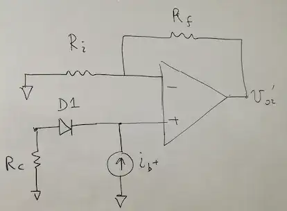

Shouldn't the input bias current shown in the above circuit (b) be modeled a bit more like the following circuit? The D1 diode is an idealized component that takes zero voltage drop and functions to restrict the direction of the current to only flow into the non-inverting input (hence, input bias current)? Otherwise, if without the diode, we'll run into the dilemma where we're modeling an input bias current that does not flow into the input - make no sense.

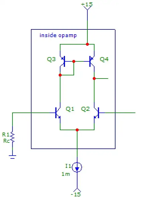

Here's a simple opamp input stage with 2 bipolar transistors (I didn't bother drawing the rest of the opamp). The bases of these transistors are the two inputs of the opamp.
So, bias and offset input current, which is the base current for these transistors, always travels in a loop, like all currents do. Since it's a loop, it has no "start" and "end" points, but it helps to always start with ground. So, the loop is
Ground
-> through caps and power supply into your power supply +/-15V rails
-> into the opamp via the power supply pins
-> through the internal circuitry
-> out of the input transistors bases
-> through Rc
-> and back to ground.
The ideal opamp model doesn't have power supply pins, so it does NOT respect Kirchhoff's circuit laws : the output current (and input bias/offset currents) just magically appear out of nowhere. I think that explains your puzzlement. But in a real opamp, of course the input and output currents loop through the power supplies.
Note that if you use SPICE to simulate a circuit, many opamp models will cheat and reference ground internally, which means the simulated current it draws from the power supplies will be incorrect, among other problems.

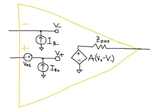

    @KMC I think this is just a visualization problem. The current sources should technically be drawn within the opamp triangle and not outside. See the dotted yellow triangle in your original image. That's how you're supposed to look at it, where the inner black triangle doesn't technically have "inputs", but its (+) and (-) are just the control nodes for the controlled voltage source of the ideal opamp model's output. If you substitute the black triangle for all that it is, then you're left with the outer yellow one, as in this image: https://i.stack.imgur.com/MkKbY.png – Ste Kulov Apr 22 '21 at 05:10
  • @SteKulov ...omg... your comment and image clears everything up for me. While bobflux's has some add in info, your comment answers (or more precisely "fixes") my question. If you can kindly move this comment to a proper answer I'll accept it – KMC Apr 22 '21 at 05:47
  • @KMC Ehhh....ok. I'll try to do that later today. – Ste Kulov Apr 23 '21 at 15:37
I think this is just a visualization problem. The current sources should technically be drawn within the opamp triangle and not outside. Refer to the dotted yellow triangle in the top-left corner of your original image, which gives you a better idea of how you're supposed to interpret it. The inner black triangle doesn't really have "inputs", but its [+] and [-] pins are just the control nodes for the dependent voltage source of the ideal opamp model's output. If you substitute the black triangle for what it really is, then you're left with the outer yellow one, as shown in the very quickly slapped together MSPaint image below. The yellow [+] and [-] pins are the actual inputs and where the bias currents flow into/out-from.
