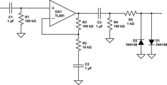

schematic
Not all of these AC coupling components are required, but I've shown them all to discuss what they do. Depending on the DC level of your source, the DC input requirements of the thing you're driving, your amplifier offsets and required system gain, none to all of these will be useful.
a) Input AC coupling, R1C1, prevents any input DC reaching the opamp.
b) Feedback AC coupling, R2C2, gives unity gain at DC, and high frequency gain of 11. Any input offsets appear at the output without the gain that the signal has. With a gain as low as 11, typical input offsets are unlikely to be a problem at the output, even if that gain is not rolled off at DC.
c) Output AC coupling, C3R4, removes any amplifier output DC from the final output.
d) The input bias currents will flow through R1 and R3, generating an offset voltage across these resistors. These voltages balance each other and do not create an amplifier output offset. For the amplifier shown which is FET input, these will be very low, and even megohm values for these resistors would be OK. With a bipolar input amplifier, values like this would be more appropriate.
e) The input offset current is the difference between the input currents. The difference in voltage generated on R1 and R3 does cause an output offset.
f) You may for input filtering or gain bandwidth reasons want R1 and R3 to be different values. This mismatch will generate an output offset voltage with the input bias current, but it will rarely be a problem, especially if you can AC couple the output.
g) Output protection of R5D1D2 limits the output voltage to around +/- 700mV, R1 limits the current into the diodes to something they and the amplifier can handle. This form of output protection will only work if +/-700mV is safe for your load, +/- 500mV signal level is adequate (600mV signals will start to get seriously distorted), and R1 is not so big that it limits output current excessively into the load, or its stray capacitance. If all of these are not met, you will need to do something more clever.

  • Thanks! Especially for the diode protection step. Quick question regarding your answer for unity gain, I've noticed (from reading and some hand calculations) that unity gain at DC and AC coupling are two different things (the former does not remove the DC signal, just makes sure it isn't amplified). Why and when would you use the unity gain implementation over AC coupling? – Denu May 11 '16 at 21:05
  • You'd usually use both (if needed). AC coupling to make the amplifier insensitive to DC inputs, and unity at DC to make the output DC shift less dependent on amplifier input offsets, which would allow you to use large resistors input to ground which could suffer large input offset current dependent voltage offsets. – Neil_UK May 12 '16 at 05:42
  • So the AC coupling does not get rid of the input bias current and the offset voltage? Even though the AC coupling capacitor is in the same branch as one of the input bias current terminals? – Denu May 12 '16 at 13:56
  • @Denu can't answer in comments, edited the question – Neil_UK May 12 '16 at 15:26
