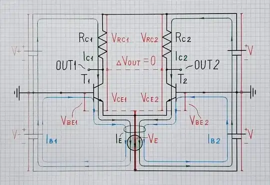

I have long been convinced that such fundamental issues are best clarified through simple conceptual circuit diagrams in which power supplies and current paths are shown. I have done this in another question and answer from which I will use some figures here.
The problem comes from the unusual bias technique used in the input differential stages of operational amplifiers. I hope you understand very well the idea of the bias voltage - it is just another pre-existing input voltage. From this viewpoint, 1-input amplifiers are actually 2-input summing amplifiers.
The biasing is made from the side of the output - transistor emitters, where a current source (sink) is inserted. This source forces transistors to adjust their base currents so that each of them passes 1/2 of the emitter current. For this purpose, the bases should be firmly fixed (like in the case of the common-base amplifying stage). Figuratively speaking, the emitter current source "moves" the emitter voltages like by levers... so the other ends of the levers should stay immovable. And if some of the bases is not fixed at a constant voltage, the emitter source will not do anhything.
Note that there are not internal paths for the input bias currents. Circuit designers rely on an external "galvanic" (low-resistive) connection that we, consumers, should provide. Usually, input voltage sources (if they are galvanic) pass the bias currents through themselves. If not, additional relatively high resistors should be connected between the inputs and ground.
Let's look at the picture where the currents are representad by closed paths (loops). The currents are distributed symmetrically in half and the output voltages are equal.
If you disconnect T1's base, IB1 will dissapear and all the emitter current will be steered to T2. VOUT1 will reach V+ and VOUT2 will be close to ground - Fig. 1.
Differential pair without RB
Fig. 1. Differential pair without RB.
The input bias currents "create" voltage drops across the input resistances - Fig. 2.
Differential pair with RB1 and RB2
Fig. 2. Differential pair with RB1 and RB2.

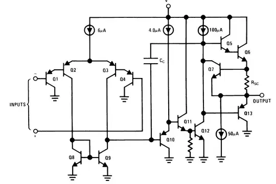

It depends on the internals of the opamp. Here is a LM328 as an example. Q1, Q4 require some base current to function.
If Q1 base is disconnected, Q1, Q2 will be off. 6µA current from current source will flow through Q3, turning off Q10, turning on Q11,Q12, and output will swing to the negative rail.
Datasheet also mentions this:
This gives you an idea of the base currents for Q1, Q4. Since input transistors are PNP, input base current flows out of the chip. If they were NPN, it would be the other direction. If they were FETs, then input current is mostly leakage, and its polarity depends on what's happening in the chip. If it has a dual input stage like in a rail to rail opamp, then input current polarity depends on the sum of the input current for both stages, so it can flow in either direction.
suppose if in given figure there is a resistance R between point B and D and if we keep increasing this resistance then output voltage will not change.
No, that's not true. The opamp inputs source or sink bias and offset currents (source or sink depending on polarity). These currents will create voltage across the resistances connected to both inputs, and this voltage is interpreted by the opamp as signal, so it ill be amplified by the circuit gain (in your case gain is -10) and appear at the output. So the output will change. If the offset is large enough to clip the opamp then the output will be stuck near the positive or negative supply, and it will no longer operate in linear mode, which means the voltage between positive and negative inputs can no longer be considered negligible.
You can calculate this in your circuit by using an ideal opamp model, and add current sources in the inputs to model input bias and offset current. You can call them i- and i+, remember each input sinks or sources a slightly different current, the difference being the input offset current. Then calculate the voltage that appears, and you should be able to calculate what happens to the output.
