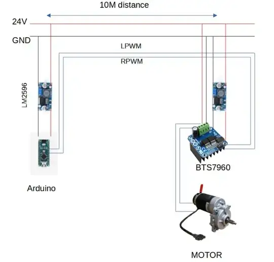

I have an Arduino Nano controlling a BTS7960 that is 10 meters away.
I have one 24V power supply.
Both the Arduino and the BTS7960 get 5V through a an LM2596 step down converter.
The BTS7960 "Enable" pins are hooked up to 5V output of the step down converter.
schematic
My problem is that this setup burnt the BTS7960 Before replacing it, I want to identify what made it burn.
I suspecting that either the RPWM and LPWM became both HIGH (from parasites + long wire ) and burnt the driver so I should add pull down resistors, or there is something wrong with this configuration and using buck converters with common GND is what caused problems.
When I turn on the power supply the motor rotates for few seconds even though the Arduino didn't give orders to turn the motor on yet.

You probably have a ground loop, and it's causing false signalling from the Arduino to the motor driver.
Basically, if you look at your diagram, you need to mentally substitute a string of resistors and inductors for all of the wires. The longer the wire is, the larger the resistance and inductance -- and ten meters is entirely too long for a single-ended logic-level signal.
Communication over that distance, in the presence of a noisy power connection* should either be done with the very careful application of something like RS-232, or -- far better -- with differential signalling (like RS-422) or by carrying the signal ground on a separate wire from the Arduino to the motor driver, and then using opto-isolators at the motor driver.
With your current setup, when the motor is on, and especially when you're driving a PWM signal to it, voltage will appear across your ground wire -- but the signals you're using to the driver board are referenced to the Arduino's ground. If the motor ground drops enough, the signals from the Arduino can both appear to be "on", even if they're not. Moreover, if the driver isn't protected, then the signals can go outside of the voltage range the chip can stand, and fry it on the input side.
Using differential signalling or opto-isolators running off of a separate reference ground from the Arduino will fix that. Using an Arduino on the left side for whatever user interaction you want, with a serial line (that itself uses RS-422) to the Arduino on the right side to drive the motor, will fix that.
You could also just generate 5V at the motor, and power the Arduino with a separate ground wire that's well-isolated from the one driving the motor. As long as you don't have any other ground connections, that may work -- but, 10 meters is a long way for what you're attempting.
Or you could place the motor driver right next to the Arduino, and just run your 10m wires out to the motor. That may actually be the easiest way to accomplish something that's electrically sound.
Having a circuit at the motor driver that won't let you simultaneously drive both half-bridges would be a good thing, too.

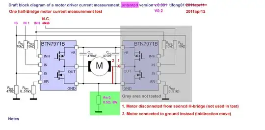

1.1 Following my locked answer (Part 1, s1.3) I would suggest to test the BTN7971B dual half bridge modules in two parts, and test only one of the parts, as shown in the figure below:
half bridge test
Notes
  1. The right part, half H-bridge #2 in grey, is disconnected (actually only rewiring is to disconnect IN2, input to half H-bridge #2 (IS, INH is common/shared between both half-Bridges). So only the left part, half H-bridge #1, is wired up for uni-direction testing on (a) PWM vs motor speed/efficiency, (b) current measurement using the IS pin only (ie, no clumsy, not so accurate, clamp meter is needed to be used as described in Part 1 (1)).
  2. The OP's BTS7960 dual half H-bridge module might have only one of the two half bridges fried. So lucky him might use this wiring diagram to check out if one of the half H-bridge is still alive, and try my suggested tip below to do some investigation research/feasibility studies, as a preparation for (firing) his coming, second new module. :)

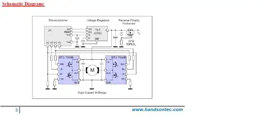

Appendix A - BTS7960 DC Motor Driver Module Schematic - Hanson Tech
bts7960 schematic

Appendix C - Why was the OP's BTS7960 Module Fried?
1. I found the Hanson Tech user guide a bit weird: its control signal names do not correspond to its schematic.
2. Its control procedure is also weird: There are two direction mode enables, one for forward mode, another for backward mode.
My immediate question is this:
what will happen if both forward mode and backward mode are enabled at the same time? Won't the module melt down?

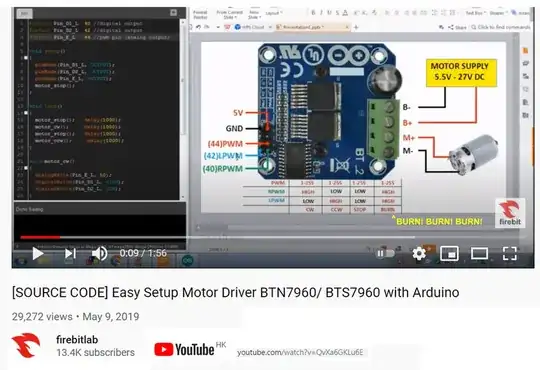

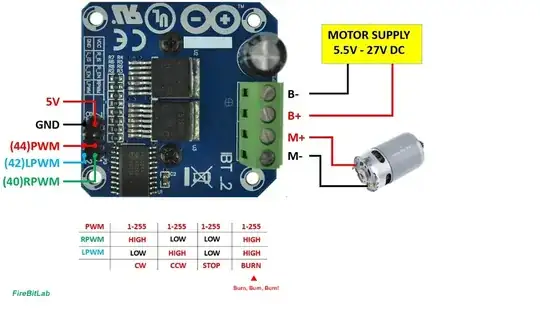

3. So I googled to know more. I had good luck: I found a YT which has a truth table that confirms my worries. See the picture below for what I found! :)
Easy Setup Motor Driver BTN7960/ BTS7960 with Arduino - FireBitLab
burn burn burn
burn truth table
Notes
  1. This is a very stupid mistake I never expected to see! I need to confirm the OP if what I saw is true!
