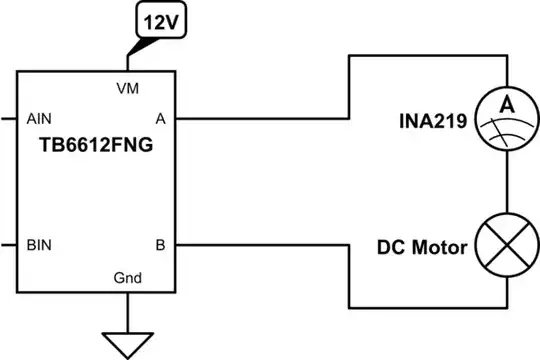

I use INA219 module to read DC motor current for control propose. I connect INA219 in series with motor as shown in schematic.
schematic

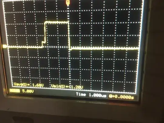

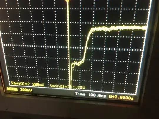

The control signal is 31.25kHz PWM. when motor turn CW (A = 0,B = 1) it work normally but in reverse (A = 1, B = 0) the current reading look very spiky and INA219 not respoding after I stop motor shaft by hand. After some investigation. I found negative voltage on osciloscope. Setup A = 1, B = 0 probe on pin A reference to Gnd. enter image description here Then zoom into falling edge. enter image description here My assumption is the negative voltage that below maximum rating of INA219 did something cause its to reset. My questions are
  1. What happen here why negative voltage is too high?
  2. How to solve this problem?

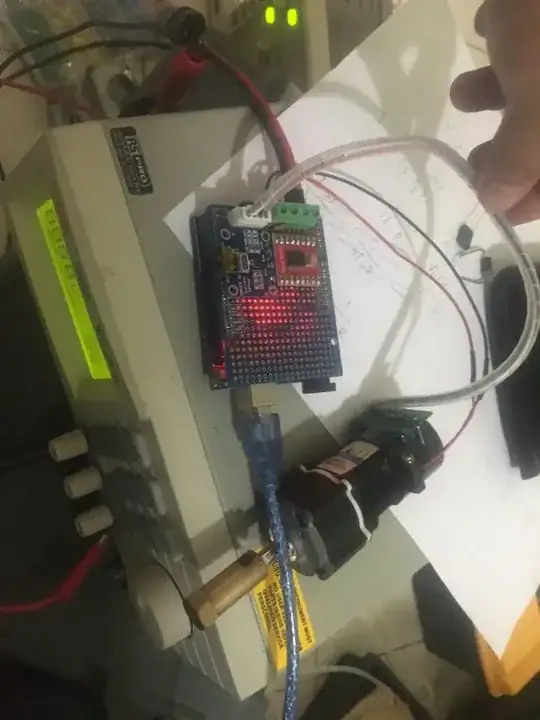

Additional Data This is my setup. enter image description here

    What is the shunt value is used for current measurement. With this block diagram it's hard to understand the setup. The scope plot shows which signal voltage across ??? – user19579 Aug 08 '20 at 07:39
    In module use 0.1 Ohm motor draw about 100 mA when I try to stop it. – M lab Aug 08 '20 at 07:41
    How are you powering the INA219? Please show the complete schematic, and if possible a photo of the setup including all wiring. – Bruce Abbott Aug 08 '20 at 07:47
    @BruceAbbott I use lab bench power supply. all circuit build on arduino UNO shield. I will upload photo soon. – M lab Aug 08 '20 at 08:07

  • Your measuring the (flowing) current passing the motor is a bit tricky. Have you considered measuring the current at high/low side of the 12V source powering the motor driver? – tlfong01 Aug 08 '20 at 09:49
    @tlfong01 Yes it just capture inductive current which I ignored. I just move to high-side to I it's work pretty fine like supper normal like it's should be. – M lab Aug 08 '20 at 10:24
  • Yes, (1) INA219 is designed to work in one direction only. So if you series it with the motor, then it is unexpectedly sensing two directions (CW and CCW). (2) When current in either direction is switched off, there is a huge back EMF voltage and current spike, absorbed by the motor driver's flash back diode, only IF INA219 is outside (high or low side) of the power circuit. (3) But if series INA219 with the motor, then the back EMF current spike will pass through INA219, which will be driven crazy! :) – tlfong01 Aug 08 '20 at 13:32
