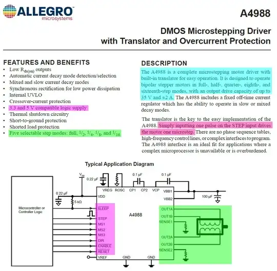

(1) A4988 Datasheet - Allergo

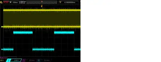

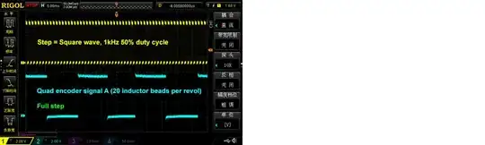

Appendix A - Testing A4988 using 1kHz 50% Ducty Cycle Square Wave
Appendix B - Testing A4899 using 500Hz, 50% square wave

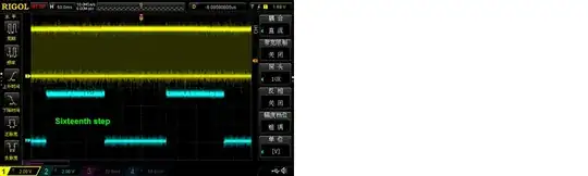

Chat record #1

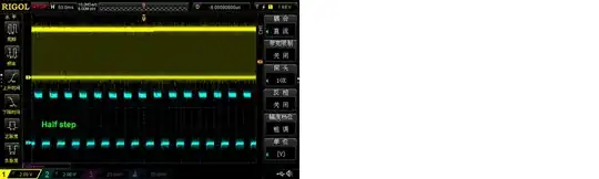

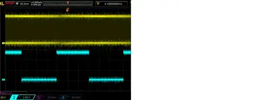

#GnuReligion, I just started playing with A4988 a couple of days ago. I only tried full step with a bipolar motor with quadrature encoder A and B signals. This afternoon I used square wave 1kHz, 50%dc as step pauses. Preliminary test shows that full step, half step, 16th step mode drives the motor from slowest to fastest. I have uploaded the scope screen captures as my answer. I don't understand how you count the step movements. Do you use a very slow frequency, say 1 step pause per second, and use your human eyes to do the counting?
full step
full step
half step
16th step

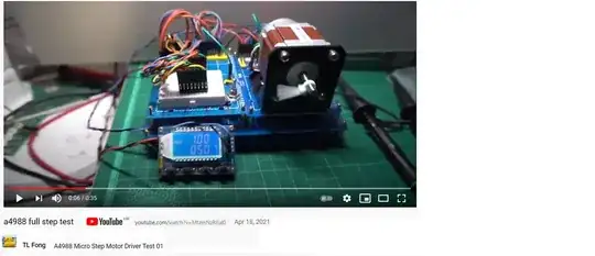

a4988 step motor test
Youtube A4988 Test 01
Full step
full
Half step not sure
not sure
Step 16
step16

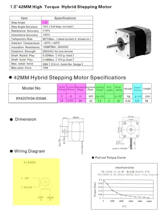

Stepper motor spec summary
motor spec summary
Notes
The above motor spec shows that torque decreases with increasing torque. For future tests, the default 1KHz, 50%dc will be used as the default.
