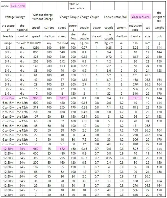

  1. A motor comparsion chart like below would give you a rough idea of the torque vs speed characteristic.
motor spec
  1. The above chart is from the following Q&A where you can find more useful info:
    How to control DC motor speed by motor driver with PWM input? Asked 9 months ago Active 3 days ago Viewed 915 times
  1. You might also find the above post's Appendix B - PWM Controlling Speed of JB37 Geared Motor particularly useful.
  1. BTW, geared motor is usually much slower, but much more powerful, which I think is what your need for your bike. In other words, the gears are worth your extra bucks. :)
