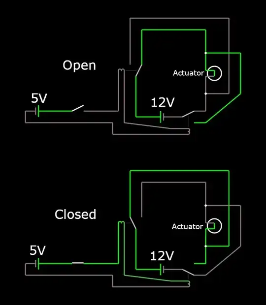

I have no background in electrical engineering at all, and only bought my first breadboard this week. I'm still completely new to this and just trying it out.
I'm trying do drive an 12V actuator, where flipping a switch reverses the polarity. Eventually I'll be replacing the switch with a raspberry pi, so the signal (is that what it's called?) is limited to 5V.
I've managed to create a circuit on my breadboard that does this using 2 SPDT relays (I don't have DPDTs), but this obviously isn't ideal.

Diagram of functional circuit with relays. A simulation of the circuit is available here. Diagram of functional circuit with relays.

    There are books full of these circuit details called Half and Full Bridges which depends on Power Loss from reactive loads and I^2 RdsOn (or Rce), switch risetime, commutating deadtime to prevent shootthru , learn the terms then search for details to write a better question if you are lost https://electronics.stackexchange.com/questions/308952/difference-between-push-pull-and-half-bridge – Tony Stewart EE75 May 06 '21 at 12:09
  • Usually a full "H-bridge" consists of four BJTs or MOSFETs is used to reverse the polarity of a voltage source, so to change the direction of an actuator, eg, a DC motor. The most common cheap, hobbyist controller is L298N, which consists of two full H-bridges, in other words, control two actuators such as DC motors. You might like to read the following Q&A for more details. How to control DC motor speed by motor driver with PWM input? https://electronics.stackexchange.com/questions/510755/how-to-control-dc-motor-speed-by-motor-driver-with-pwm-input/510834#510834. Cheers. – tlfong01 May 06 '21 at 13:07

The first thing we need to know is how many Amps the motor requires. We already know the motor is 12VDC.
The worst case with a DC motor is when it is stalled - the 'stall current'. Either the motor manufacturer with specify this (hopefully) or you can measure it. Use an Ammeter with the motor stalled and read the value.
Based on these values, we want what is called a 'H' bridge as Tony mentions. For smaller currents, there are integrated circuits that do this. Once you start getting up over around 10Amps, then we need a discrete approach. How do you chose what transistor device? There is no one choice and there are many variables to balance. Designing a 'h' bridge as a first project is not advised.
If all you really want to do is reverse the motor, then use relays. There's plenty of relay boards suitable for the raspberry pi (note the raspi logic levels are 3.3V NOT 5V) that have a suitable transistor and circuit. Relays are pretty hard to kill vs h bridges that one slip might turn them to smoke.
As well, you will want to put a varistor across the motor to suppress inductive spikes that will upset your raspi. Something like a 7mm or greater with a voltage of 14V or thereabouts. I can say conclusively from experience that this is required - a colleague ignored my suggestion and found out the hard way.

  • Thanks for the comprehensive answer. The manufacturer unfortunately doesn't provide the amps and I don't currently possess an ammeter. It's a car door lock actuator, if that gives you any indication as to the amps it pulls. I've been able to get it to actuate with sufficient force with a 5V-12V step-up usb cable from amazon, but I'd guess that's under the ideal amperage. Since this is beginning to look more involved than I bargained for, would you suggest a controller module like this one? Also, do you know if these modules can be configured to pulse? – Anthony A May 06 '21 at 13:03
  • The L298 might work. As for 'pulse' operation - that's up to whatever is controlling it. – Kartman May 06 '21 at 13:11
  • Just to clarify, an H-bridge circuit should always have current running one way or another through it; is that correct? So an H-bridge by itself couldn't be used to pulse? But since modules such as those linked don't seem to be just H-bridges, but seem to contain some additional logic, I was wondering if a pulse mode would be part of it. I was just wondering if you knew off-hand if that was the case? – Anthony A May 06 '21 at 13:16
  • As far as I can see, the module you linked has no additional logic. Your controller tells it to go fwd, rev, open circuit or short. – Kartman May 06 '21 at 13:29
  • Ok, Thanks. I hope to learn more about ee overtime, but for now I'll just buy the module. I think I'm less likely to destroy my stuff that way. – Anthony A May 06 '21 at 13:37
