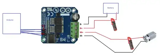

How I measured the efficiency:
  • I put a clamp meter between the battery and the BTS7960 and I have check voltage "B +" and "B-" terminals. Voltage is 29V and current is 11 amperes so my battery is giving 320 watts.
  • Then I checked the consumption of the DC motor. I put a clamp meter between the BTS7960 and the DC motor and I measured voltage "M+" to "M-" terminals. Voltage is 13,6 and current is 13,8 amperes so as I understand my DC motor consumes 187 watts.
Either my PWM module efficiency is very bad or I'm doing something wrong.
The BTS7960 module became really hot while testing.

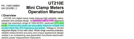

(edit)Additional information: My clamp meter is Unit UT210E. Also you can reach datahseet this link:
UT210E English Manual
Also I measured current with multi meter(Unit UT39C)
