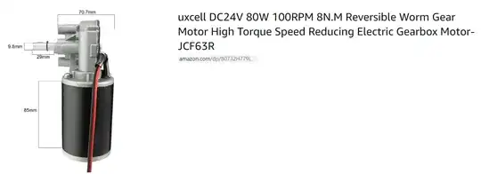

  1. Uxcell JFC63R Gear Motor (Appendix A)
    My first impression is that it is a very powerful motor. I usually first look at the motor shaft. The shaft is 10mm diameter, which is for very powerful motors. The power is 80W, an of course is very powerful. This implies big current is need to drive this motor, and that the back EMF, which is proportional to the square of the motor current, is huge, and needs a powerful and fast Schottky flyback diode to absorb the motor's inductive energy, when the motor current is switched off.
    Another implication is that even with light load, the motor might not move, and the stall current would be many times of the operating current, and the motor driver might easily get fried, if there is no over current and over temperature protection.

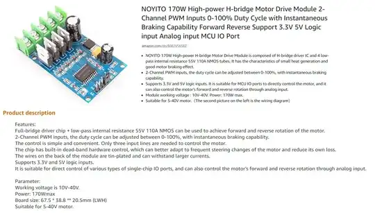

  1. Niyito 170W, 110A Motor Driver (Appendix C)
    The current rating looks OK. However, there is heat sink used, which might be problematic, if there is no temperature protection.

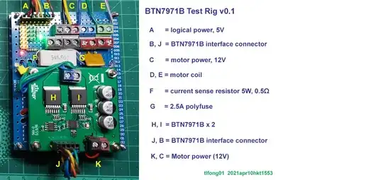

Appendix D - Old BTS7970/BTN7971B testing images for the OP's reference
  1. BTN7971b module
btn7971b
  1. BTN7971B wiring
btn7971b wiring
  1. BTN7971B testing 1/2
bth7971b testing
  1. BTN7971B testing 2/2
half driver test

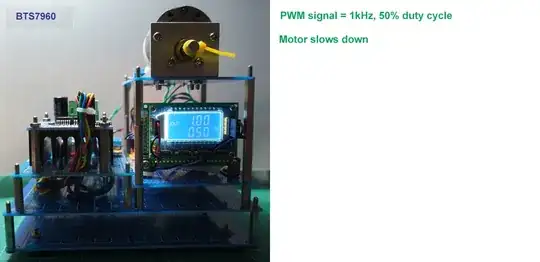

  1. BTS7960 PWM Test
(16) Youtube Video of BTS7960 test 2021apr1601 - 2021apr16
bts7960

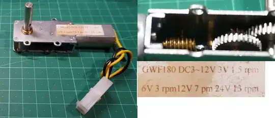

Appendix E - 3V~24V DC Worm Motor

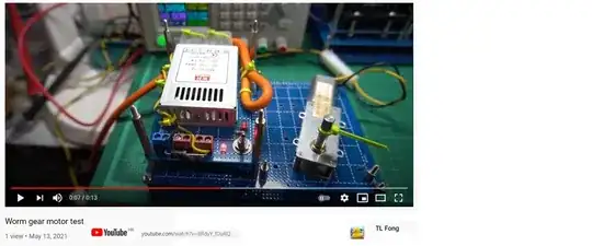

Appendix F - Worm Gear Motor Preliminary Testing Notes
(20) Youtube Video Worm Gear Motor Preliminary 12V DC Test - tlfong01 2021may13
Now I am doing a preliminary test. I used a multimeter to measure the worm gear motor's resistance and found it 28Ω.
So the operating current should be I = V/R = 12V/28Ω ~= 400mA. Then I use a 220VAC to 12VDC 1A PSU to drive the motor.
I found the motor moving slowly, as expected: youtu.be/8RdyY_lDuRQ.
worm gear motor test
